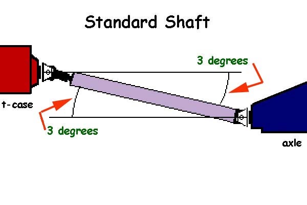

here's a pic to show you.... as long as the angles (noted as 3 here) are within the operating angle of your series joint, your good... it's usually best to have the pinion down a degree or 2 to allow for torque...
get yourself an angle finder...
