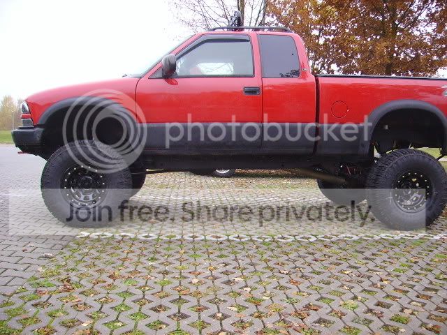

I see your link and read bds 5" with t-bar relocator kit .
that's what I am doing now for a customer. had some parts quality problems with centerlink . bds took care of it after a little back/forth . also newer rear parts not corrected in the directions but we got that figured out in phone calls back/forth .
looks good .
did you wish solid axle after ? :rolleyes:
yea, 5in BDS, t-bar relocation kit, add a leaf in the back, and a 2 in body lift. BDS is a really good company. i had good luck with them.
if you haven't already.. the torsion bar cross member has to be moved about 2" inches back for the relocation. also i had to grind down the centerlink so that the pitman arm bolt would clear the front diff.
i wish i had done an SFA.
ya found out today the relocator kit said 3" back for t-bar crossmember . but in real life its 1.5 for this truck . :angry1:
but it looks so clean with the bar's up high like stock .
ground the diff ear / pitman arm nut & thread stubb down to clear its range of motion. still got good nut and cotterpin hole just barly . :whistle:
