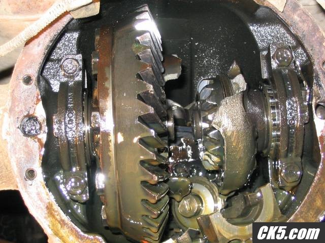

The G80 in the 14SF and 14FF axles is significantly stronger, I did this to my 8.5" on the street, while the G80 14SF in the same truck has been going for almost two decades without issue. These are expensive failures.
