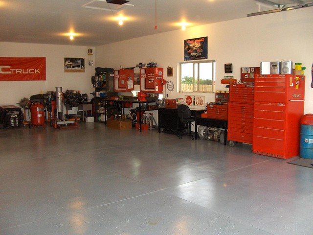

Like ryoken said, you get what you pay for. I did my 1000 sq ft detached garage with Quikrete epoxy floor coatings in 2006. I think at the time it cost $400 for the material where the good stuff, like U-Coat-It would have been over $1000. Looking back, I wish I would have just ponied up the funds and got the good stuff the first time. The Quikrete looked awesome the first few months but quickly went downhill. For the first few months it was slicker than hell to walk on too when it was wet. Oddly Superswamper tires leave permanent marks in the Quikrete floor coating. Not sure what it is about the tire composition of Superswampers that stains Quikrete so badly.
Quikrete right after applying it.
7 years later. The floor was actually just hosed out before I popped this spring pack out. The floor is just this discolored and stained. The only thing it is not doing is peeling. I figured it would peel but it never has except in two spots where it got burnt welding.

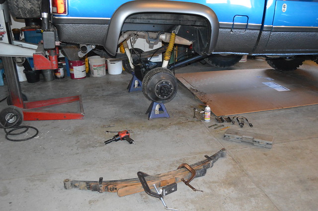

This photo is from 2008 but the only one I can find where you can see how the Superswampers leave permanent marks on the flooring :dunno:
