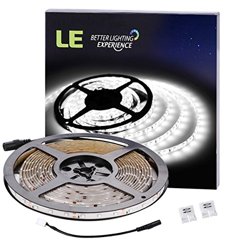

I used these,
XAFzEC
in rows of three on a 2x4 that I pre-sprayed with 3M contact cement since the tape glue as supplied is pretty weak.
I put up four 2x4s and they light up my 30 x 30 garage very well. Not quite sunglasses strong, but very nice and white. That's 12 rolls of LEDs and two power supplies.
With a few well-placed over-desk LED lights, this will be complete as a guitar building/welding/pipe fitting/fencing shop. Oh yeah - and a canoe shoppe!
LINK: https://www.amazon.com/Waterproof-Flexible-Lights-Daylight-Lumens/dp/B00JQV6U7Q

I've read alot about this.
Any issues so far
The power supplies are a switching type in that they don't use power until there's a load on the other end. My idea was to keep the power running - not switching it off at the 120 volt supply and it allows the LEDs to light up instantly. Otherwise there is a delay of a couple of seconds before they emit light.
There are no drop outs and the prophecy of them lasting 50K years - well, I won't be around anyway to know if they run that long or not.
They DO emit a little heat - not to burn anything, but they get warm a bit.
Be warned that the glue on the back of the tape is too weak to last very long, hence the spray contact cement in a can by 3M. .
So couple more questions for ya @Joe In Montana .
How high are your ceilings?
How far apart are they.
I'm assuming since they are 16 ft strips they are 16 ft long.
I think I would probably bend up some thing gauge galvanized if I go this route.
The other thing is how about damage? Do you think being exposed to a garage environment might cause issues?
I do mostly metal fab stuff and I'm so so, hence lots of grinding dust
@blazinzuk I have some if you want to look at them. I use them for interior lights in the blazer and the truck
10 feet
About 5 feet
16.7 feet or 5 sillimeters for any Europeans reading this...... if you want though, you can safely double back the LED tape to make them a tad over 8 feet long each.
I've seen them glued to old fluorescent tube reflectors, so metal doesn't seem to be a problem.
Physically smacking them, like any other lights, might damage them too....but they are cheap!
Welding splatter shouldn't get that high - but grinding spray might. Hmmmm, I don't think that's a problem since no actual circuits are exposed.
Moisture shouldn't neither as you can get them in waterproof designation.
Solvent vapors might cause the contact cement to yield though.
I do mostly metal fab stuff and I'm so so, hence lots of grinding dust.
Dust falling down can't matter since mine are flush to the ceiling and even though I have been known to convert my shop to a vehicle painting booth, I don't think much of anything can fall UP to contaminate them.
