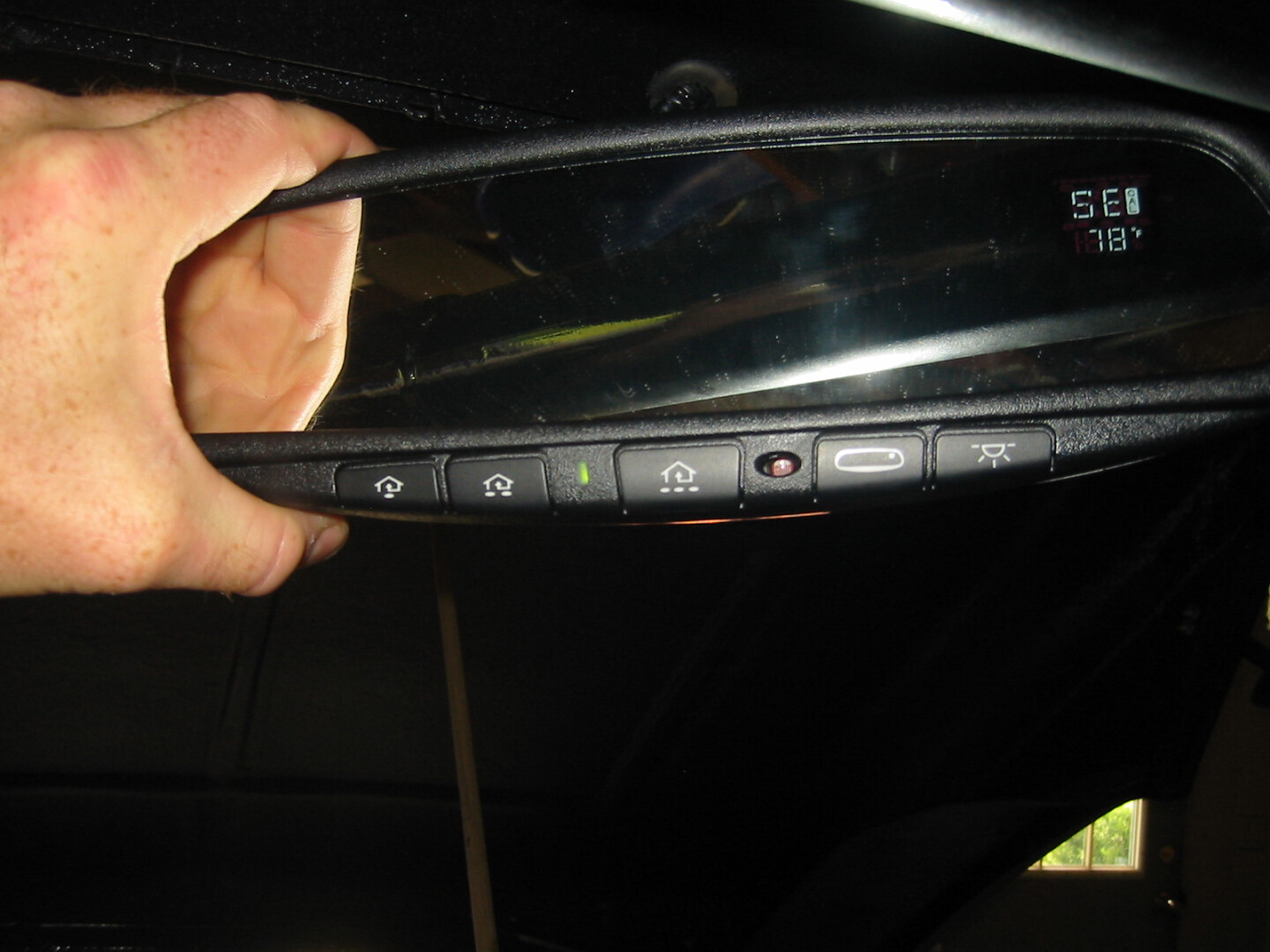

    Here's a pic, of course there's I still need a windshield in there!:
    [​IMG]
    It was quite a project fishing the wire harness through that 1973 K5 header. Took about 8 tries before I finally got it all the way through. I had to make a few modifications to the supplied Universal gentex harness though, they had a big flat connector about 1' from the mirror itself, might fit nice under a new suburbans headliner, but no way was that going to even fit in the 1973 K5 header, let alone getting it in there. Since the mirror has a plug disconnect on it, I saw no need for that big flat disconnect a foot from the mirror disconnect, so I elminated the connector all together and soldered all those wires together.
    Works perfect, wired in to the dome lights, which is nice on the 73, where overhead light is hard to come by in the center. Garage door opener works good, compass needs calibration (drive in circles it says), and now I can see why I'm sweating so much out in the garage.
