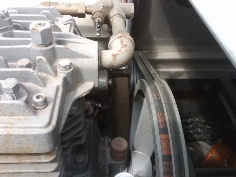

all our service trucks have 9 or 11 hp (can't remember 'zactly) Honda powered 3 head compressors. to a remote tank. thats on the top of the truck. most gas powered I've seen, mount it on the side of the tank (tank laid over, not upright). and have a simple single shieve v-belt drive. to the compressor.
I'd imagine you'd just have to build a bracket welded to the tank to be able to mount the engine. then run the v-belt from there. Seems like a bigger gas engine is going to cost an arm and a leg too.

for visual. heres my service truck gas air compressor. you can see the discharge is just a hose to a bulkhead fitting to a hose to the remote tank on the roof. see it doesn't have to be mounted on the tank.
