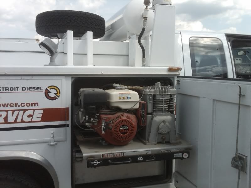

I had a 9 horse Honda powered compressor on my old service truck. it was decent. I could run my die grinders, and guns. but I also had a 20 gallon tank on the roof that it fed.
