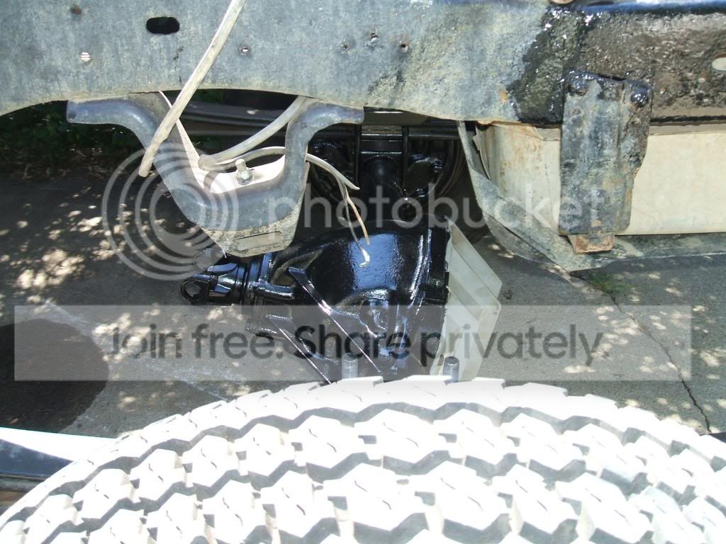

First off, on the K5 frame you will have to modify this section. Otherwise the shackle hanger wont sit flush. We made a slice then hammered up that hump at the bottom of the frame & re welded it.
With the 14bff in place:

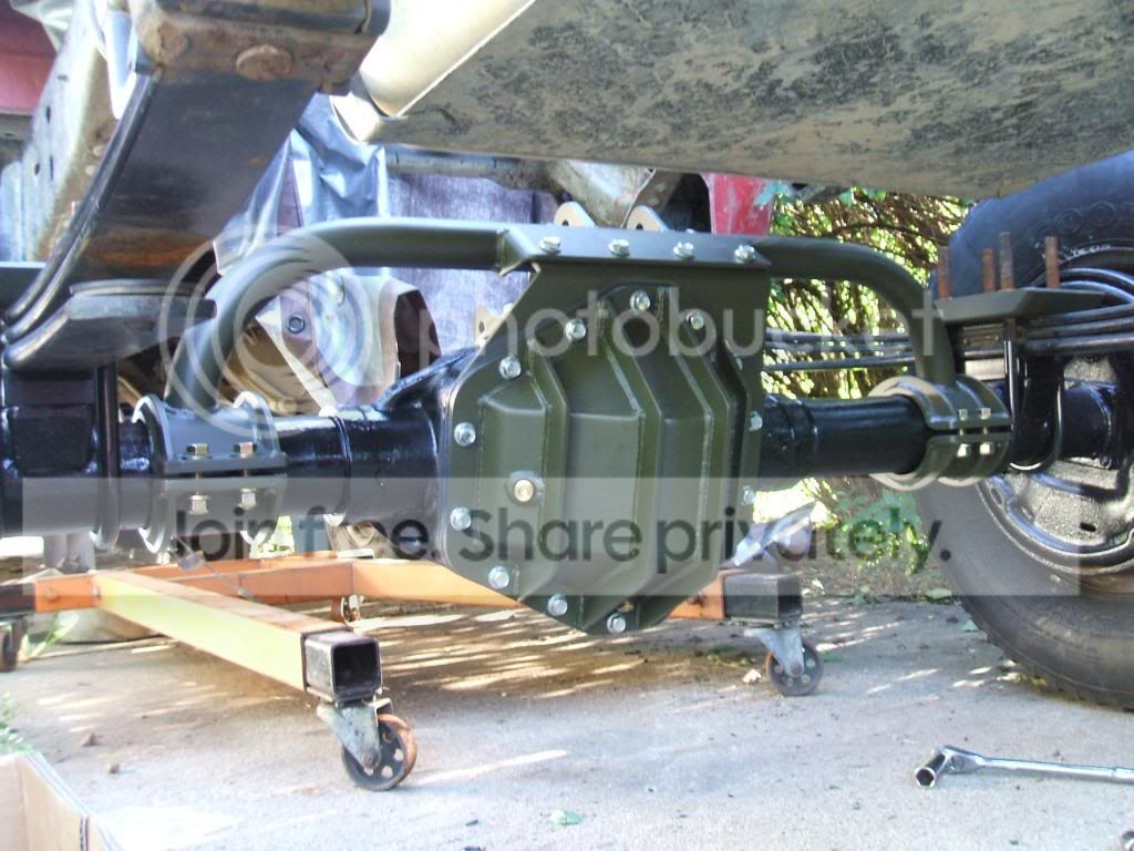

With DIY4X backbone truss installed:
Oh and I take back my comment about the diff cover leaving scratches on the skid plate.The scratches were actually from the brake line union where the hard lines connect to the flexible line. The piece is bolted to the top of that truss (in between the two right side bolts where the diff ring connects to the truss.) The bolt that attaches the brake line is what has rubbed on the skid a few times
