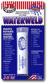

NAPA used to sell one with fiberglass in the kit and it worked great for holes and crackes.
This works for SMALL holes
This one is like the one NAPA used to sell
They do still sell it this is the one I would use.
OK I tried this.
It would work awesome if the hole weren't in the bottom of the tank.
I wiped it dry and got the hot putty on it before it even started weeping, but after about 10 minutes enough gas crept under it that the putty fell off.
So I did it over again, only this time pushed the putty on with a 2x4, and jacked just enough pressure under the 2x4 with the weight of the vehicle to really squeeze it in/on there.
Will report back tomorrow. Leaving it like that in the driveway overnight.
If it does dry like that, I think I'll go around the edges of the putty with JB-Quick tomorrow evening. With the 2x4 on it like that I couldn't squeeze the edges down nicely like I think you're supposed to.

Spend the few dollars more and buy this one! NAPA $12.99 vs $7 or $9 bucks for others.
When my father had the construction company we used it and when we did it sealed each and every time. I still carry one in my Blazer. IMHO you are just wasting time using the others.
