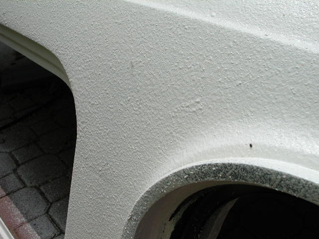

I would like some opinions on a product called Gator Guard . I have been studying different coatings and I have a chance to get the inside of my Blazer tub and the underside of the body & wheel wells done at a professional body shop with all the correct equipment.
Prep work and coat thickness will be under my control but what I want to know is anybody's opinion on Gator Guard - have you been happy with the end result , appearance , texture , durrability ????
Please any pro's and con's are wanted .
Thanks , Tom
I belive BobK coated his topper with it and was pleased. I haven't seen him post here lately though. :thinking:
The Gator Gaurd is holding up nicely on my top.It IS designed as a spray on bed liner so I'll assume it will be fine to cover the inside of your truck with it.
I applyed it with a "shutz gun".
Oh,75-k5,I'm on CK5 every day,I just don't post much
i used gatorgaurd on my bed rockers grill. the grill is holding up. as a bedliner it sucks! too hard,chips right off! yes i prepped correctly. the problem with it is that it is epoxy based and very hard so it is brittle i would go with a urethans based brand. something with flex.
