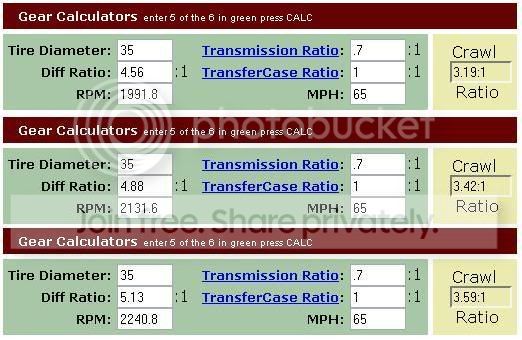

    I vote 5.13's but I guess that depends on how fast you want to go on the highway...
    All the same setup... TC in High, tranny in OD with 35's @ 65mph... check out the RPM differences...
    [​IMG]
