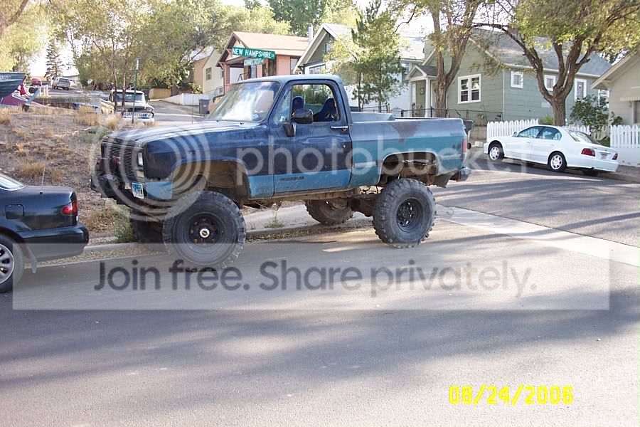

if you want sweet flex you should run the set up im going to run (in the process) im running 5" lifted 64's in rear with shackle flip (just did that this summer) and in the spring i will be swapping in 4" lifted 56's up front. i adjusted it so the 64's moved my axle back 2.5" instead of the typical amount by moving the front hanger forward a little bit. its ~9" lift. thinking about a 1" body lift (needs new body mounts so i could do both at the same time) so i can clock the t-case.
heres a pic of how it sits now with the 64's shackle flip and 39.5's and trimming (that is all the trimming i needed, have had the rear flexed out and just clears). its currently got 8" BDS and 1" zero-rate up front. 56s will be swapped in in the spring.
