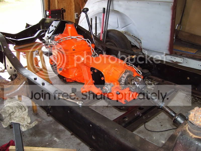

If you can find it i would run this crossmember, its waht is going into my mud truck.
Kind of hard to see, but there is 2bars, with a skidplate inbetween them.
If you are goign to shop for crossmembers, 1/2 and 3/4 will interchange, but not 1ton. They have a wider and taller frame.
