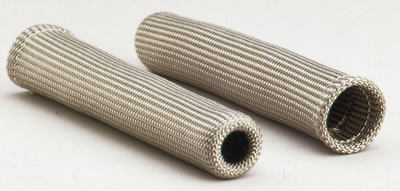

    [​IMG]
    I have a set of spark plug protector boots like this on my wires and so far haven't had a burnt wire. Been about 6 months since installed headers and boots. Here is a link to Summit sales page.

    My buddy has angle plug heads and headers that fit "not-a-so-good" and he uses the same type booties on his wires.
    Also, are you using 90* boots or straight? With manifolds they should be 90*.
