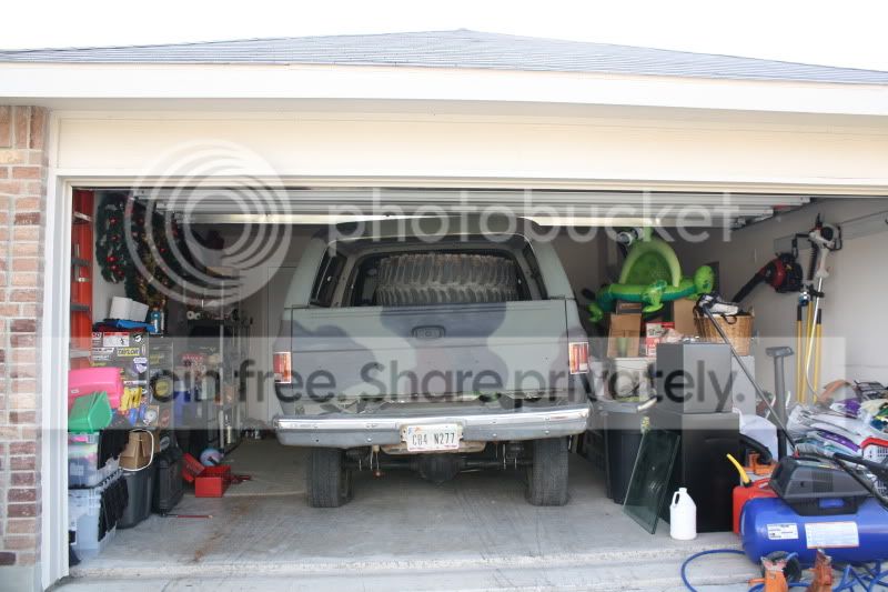

Got my truck in the garage by putting a set of 15s on and letting all the air out just barely scraped the door pulling in. Truck had a 8in suspension and 3in body and 39.5s

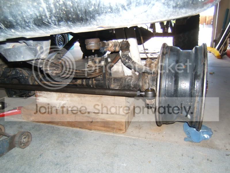

I used to use tires on these small rims but the tires would buckle and sometimes create enough lift to cause the roof to hit the door frame. Usually I can pull just the rear tires off and replace with these rims, but with the hard top on I have to do all four tires.
It leaves a mark for sure, but if you go easy it's not deep enough to scar the driveway.
