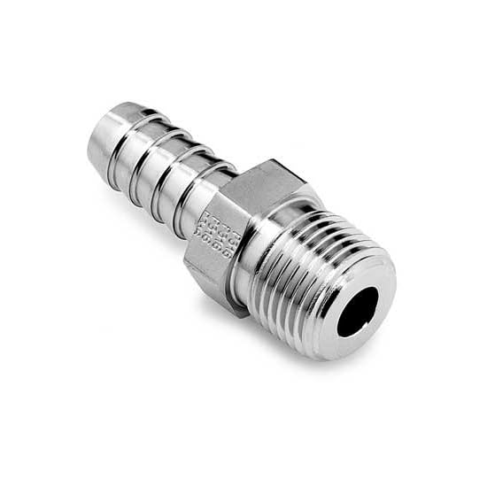

:mad::mad::mad::mad:totally pissed off right now, almost finished rebuilding my axles and destroyed the breather pulg/ hose connector (does anyone actually know how that part is called?) Where can I get that thing new, tried ebay.com but I havent been succesfull yet :doah::doah::doah: ... (didn'T get it out of my spare axle either, also broke the connector :crazy::crazy:)

Thought they were just threaded hose barbs. Your local hardware store (err, "DIY"?) or plumber's shop would have these, brass fittings usually.
If the hole's not threaded, you could tap it to put in a hose barb, or just epoxy one in ;)

Yup, it's nothing special. Just crank on of these bad boys in there and call it good. Pic is just for reference, you may want a different length/material/shape depending on your configuration but you get the idea.
I pounded a 3-4 cm piece of 10mm fuel line in there with the flare pointing up so the vent line is snug over it...
