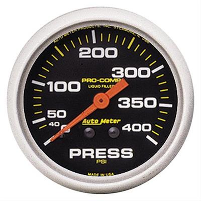

I'm actually thinking of adding a pressure gauge
to my arsenal of gauges.. with line pressure also being such a critical thing with the 700r4's, along with heat... not to mention the whole BTO warranty stuff... I'm leaning towards them, but everything I'm reading isn't great on BTO..
