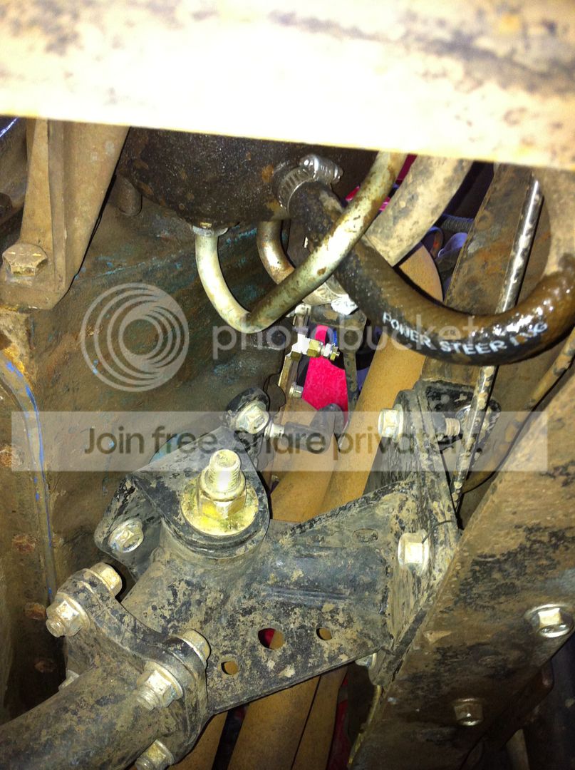

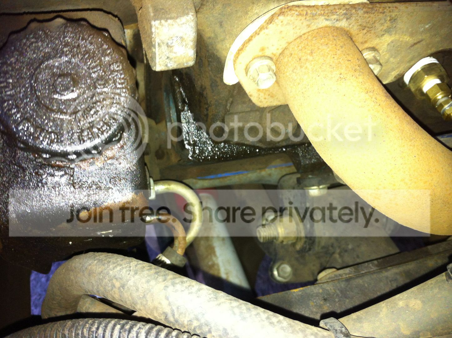

speaking of kerts crossmember, did it have any impact on the bolt that goes through the steering pump bracket? I can never get that one as tight as I'd like on the stock bracket.
Z, if you get a chance, a pic of that area would be sweet... unless you use a different bracket. :P
To be perfectly honest I'm not even really sure what bolt you're talking about... I have the serp belt setup from a trans am on mine though, so I imagine I don't have it anyways. Just in case I'll grab a pic in a second here anyways.
yeah, doesn't sound like you have the same setup. on the stock power steering pump bracket, there is an arm that goes back to the motor mount and is held in place by the front upper bolt. it's a screwy design and a pain in the ass to deal with.
I definitely don't have that, but I don't remember it being that way before either really...
Here's how she sits now (don't mind the mud/nasty looking P/S cap, or the seeping head gasket-all of this will be fixed when I put the new motor in eventually:haha:)
thanks man, those pics are perfect. I'll try and remember to take a pic of what mine looks like so you know what I'm talking about.
looks like kerts would be a lot easier to deal with. now I just gotta see if that crossmember would still be usable if I swapped in a 6.0 since that is my ultimate goal.
It will just tell him that and he'll make the plates that mount to the motor to fit the 6.0 if the bolt pattern is different on the LS motors. That'd be sweet!:thumb:
