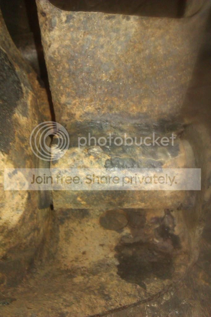

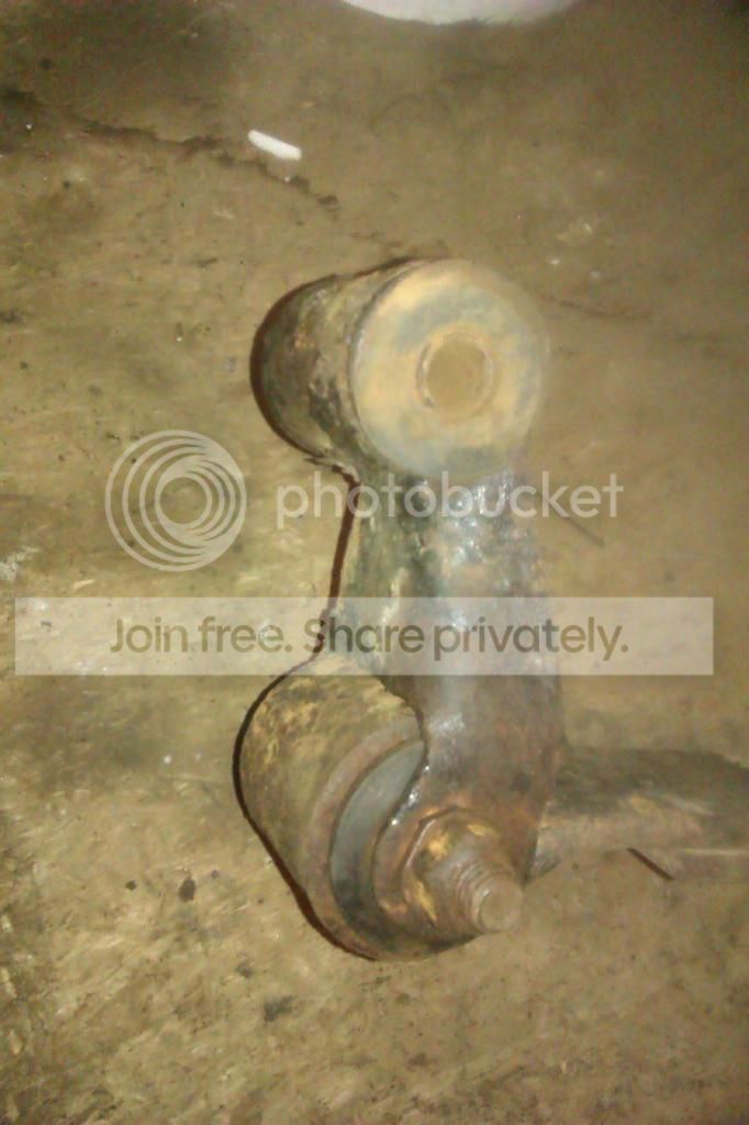

Defintly go with polyurethane bushings, when I first did my truck I did all poly bushing, except for one shackle I replaced that still had the OEM rubber. 6 years later when I had the take things apart the rubber bushing was cracking/falling apart and the bolt was seized. Every other poly bushing was good and bolts all loosened off.
Poly:
Rubber:
