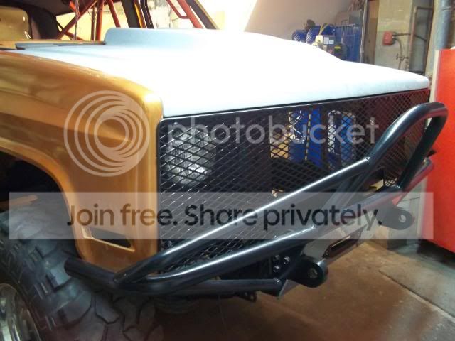

I have a cheapie $50 holesaw notcher from eghey.. it does ok.. i find anything other than a 90 it's much easier to use other methods, meaning a chop saw or plasma depending on how funky the joint/node is... but Pro tools has a couple nice holesaw ones between $200 and 300..
and I've done my bumper and cage....
