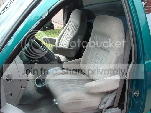

This was my 95 GMC. I took the bench out and put some 88-98 van seats in there. I'd imagine they'd work just as well in an older style burb as I'm pretty sure the mounting tabs were designed for a flat floorboard. COMFY! Not to mention the driver seat was power and only needed a power and ground to operate.
