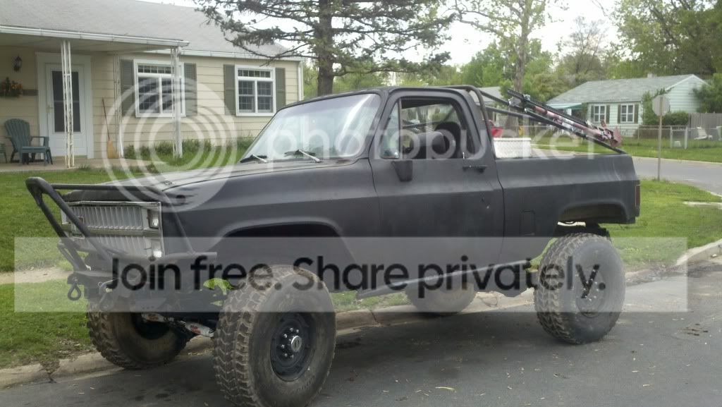

What brand spacers did you use? Can you post a picture, I was thinking of doing spacers instead of recentering but thought the front hubs would be sticking out a long way and get mashed in the rocks.
Sorry, missed this post...
I'm going to swap on dually hubs but i'm yet to have any problems with my spacers and know lots of guys who have run them with zero issues. Either way the spacer debate has been going on for along time, i'm going dually because I want the equivalent of 3" of back spacing that the dually hubs will give me rather than 4.5" with the spacers and the extra 3" of track width will be nice as well.
Here's a few pics:
I'm also eventually going to swap in a newer dually 14 bolt with single rear wheel hubs and discs to get the same track width as the front, but the spacers will work in the rear for now.
