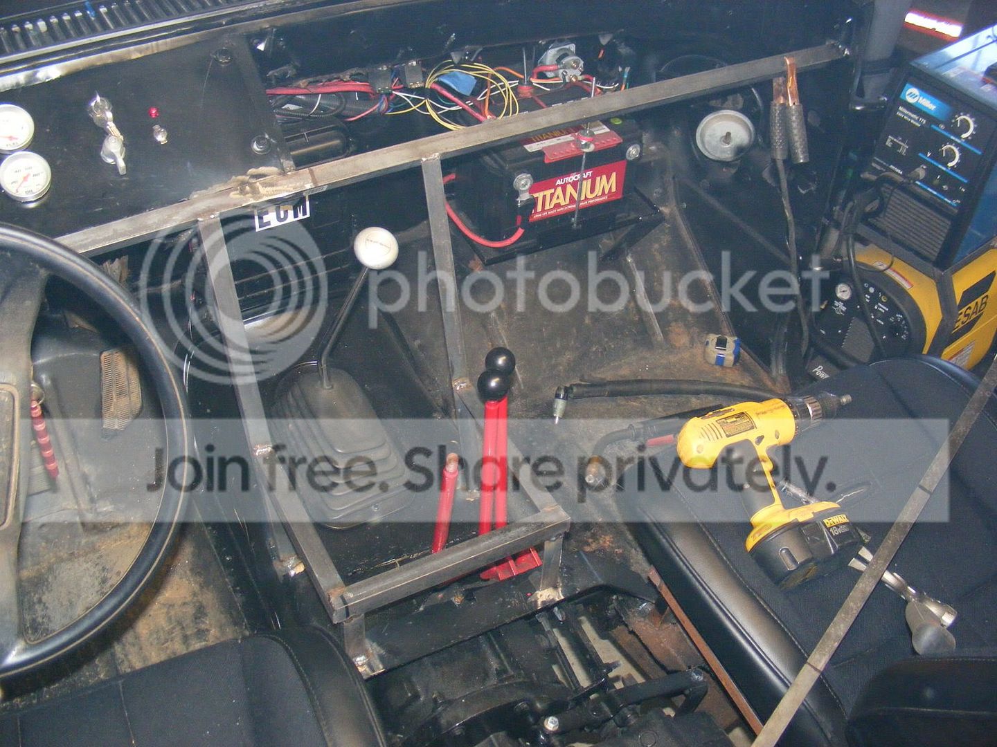

My attempt at a center console/dash. Im getting my taxes done tomorrow and will get started on the cage when the money comes in. Hopefully able to start wheeling again in the early spring
Lookin good are you gonna fill in the center with sheetmetal? the boots can probably be bought from NWF.
yeah, I have to got in to the station tonight, so I ran out of time. Should have the sheet metal in on Thursday, I'll post some pics then. I think i found so on ebay for like 40 bucks but i'll try NWF first. I hate ebay!

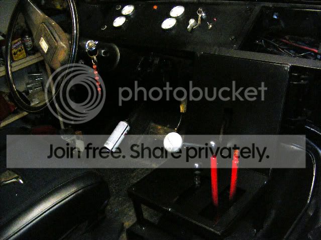

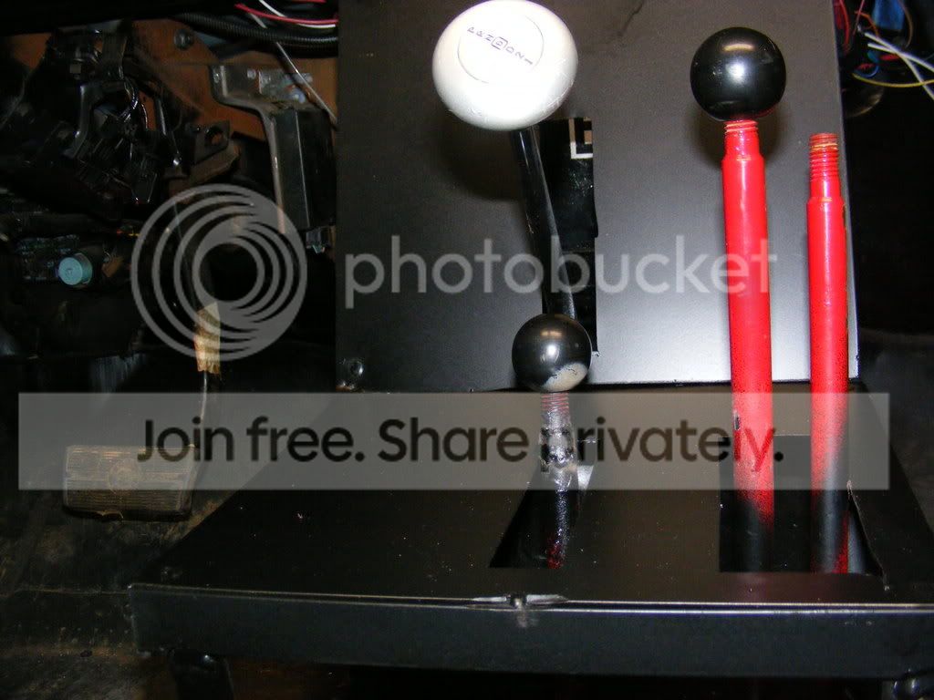

Well had a little bit of a good day, mostly because I got an ass ton more money back then I thought for taxes. So I'll be able to get the tube for the cage as well as take the wife on a cruise (to get her off my back) for v-day. I may have made a boo boo though. If I'm in low on the 203 and in first gear in the trans witch I should never have to be (auto) then the shifters would hit. So to fix this I shortened the shifter for the 203, not thinking that there wasn't enough room for the shifter boot:doah:. How tall are the triple stick boots for ORD or NWF? I can always extend it at an angle to the driver side if I needed to but what do ya'll think. Now I will be adding sheet metal to the sides and over the doubler itself, so be kind. I kind of like the idea of knobs for shifters, so I may shorten the other two. And sorry for the giant second pic
Those are the boots that NWF uses they are evenly spaced between the three shifters and about 6" tall im guessing that boot should work fine for your setup if not you could always bend the middle shifter towards the left:D
