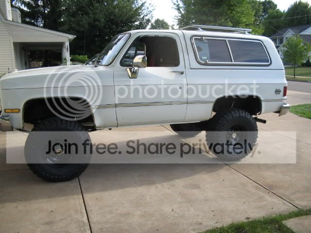

ok so i put in the smaller 4" block and lowerd the tcase an inch
i have a small vibe but its liveable and i prolly wont mess with it

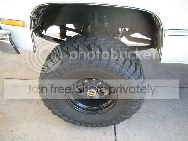

front clearance

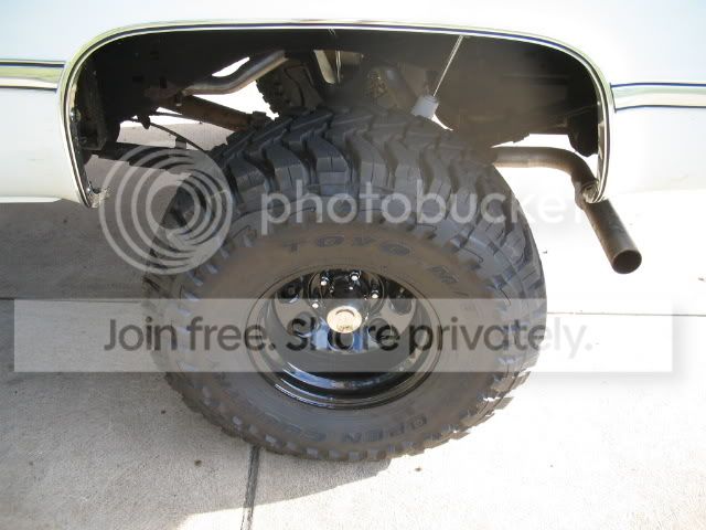

rear...
so far heres wat all we did
4" TC springs + 0rate
4" block
extended stainless lines
gabriel shocks
new front wheel joints
new warn premium lockouts
new balljoints on driver side
new rotors new pads
new calipers
new front driveshaft ujoint
new rear driveshaft ujoints
lowered the tcase with flat bar
um.. thats it for now
ill get more pics later

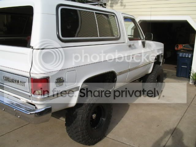

That thing is nice!! Will you be storing it for the winter or are you going to drive it?
Stocker.
Nice. It almost looks like it just left the factory. They seriously should have come like that. (And offcourse with the "unbeatable" D60/14B combination..)
