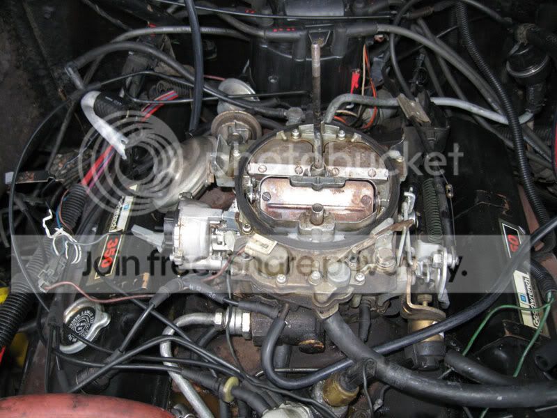

Decided to remove all the smog. All I gotta do is go get some plugs for the exhaust manifold, and finish up these lines. I TRIED to do it systematically so I could remove everything smog related, and reconnect what wasnt. But a lot of 'I'll remmeber where that goes and get it in a min' and breaking a couple of the brittle hard lines left me with a few open ends by the time I was ready to plug the lines back in. So I found my camera and I'd like to play the 'what is that thing' game.
Numbers I got was 17085226/3124HLY So I know it's an '85 4bbl (duh) Fed Emission for an auto Chev. Built Nov 8th '84. I also saw a sticker reading remanufactured on the back of the carb. But where do I find those numbers reading Mw4 something or another, and what do those mean?

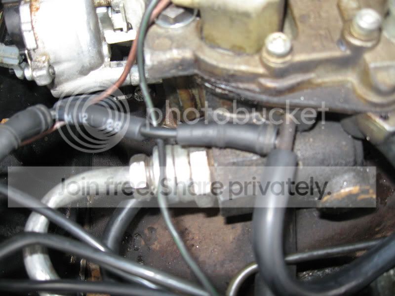

So what's that thingy and where does it supposed to go. I think T'd off with the distributor on the top left port (looking at the carb).

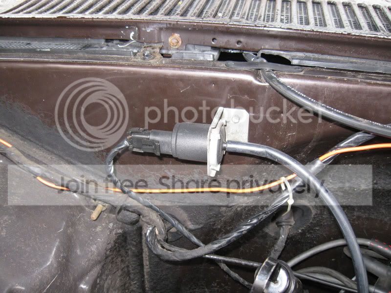

What's that thingy. I think it's for the cruise? Directly behind and to the left of the booster. I believe it was split with one of the small hard lines comming from the cannister, and intergrated into what I believed (from reading the chilton book vac/emission diagram) was a deceleration valve? went to Egr stuff and the smog pump. Saved what I think is this 'deceleration valve' cause if it's what I think it is, it goes to the cruise controll, unfortuantly the mount to the top of the Alt was broken, so it was just sitting there.

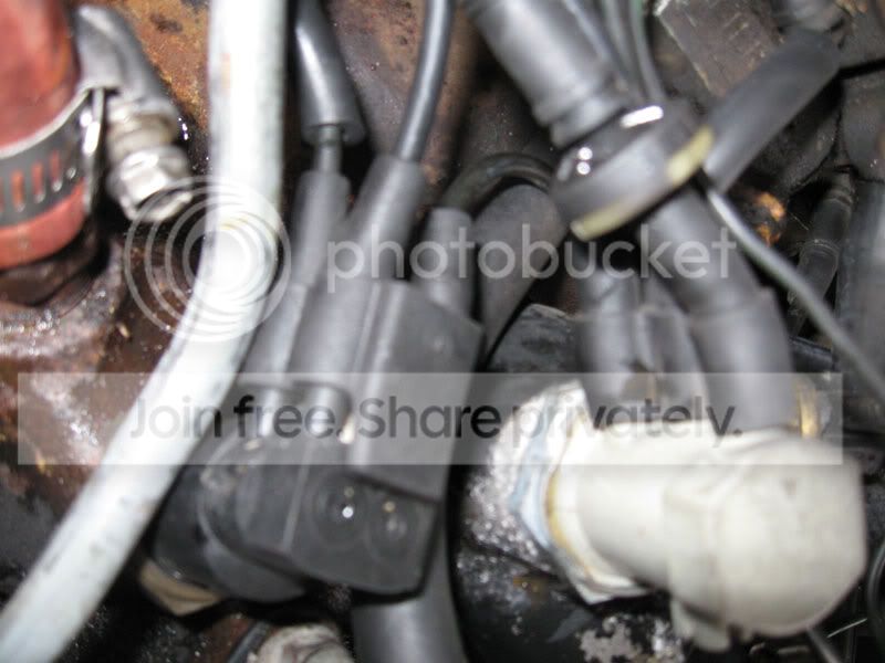

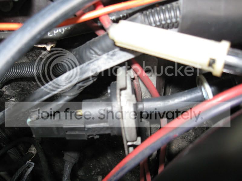

And both of these. All but one of the lines to one of them are untouched. And I have no idea what the missing one goes into, or how Important they are and if I could get rid of or plug or bypass any of them.
The part of the T facing the radiator I have going to what I think is the cruise thing. The part of the T facing the passenger side I have split between one of the lines that ends up comming from the distributor and the picture of the thingy on the firewall. Thingy #1.

That carb isn't as bad as mine. Mine has the TPS sensor, computer, and non-vac advance HEI.
The valve thing on the exhaust manifold is for your air injection pump. Looks to be missing anyway. Doesn't hurt anything to leave it.
The white vac valve in the water neck is for your dizzy. I believe you can chuck that and run your dizzy vac line straight to the port on the front of your carb. Where your accelerator pump plunger is, straight below it. If there are more than 3 lines on that temp vac valve, then I don't know what the other stuff is lol. One should be coming from the carb and one goes to the dizzy.
If you don't have smog, you can chuck most of it. 99% if you don't have Cruise or AC.
