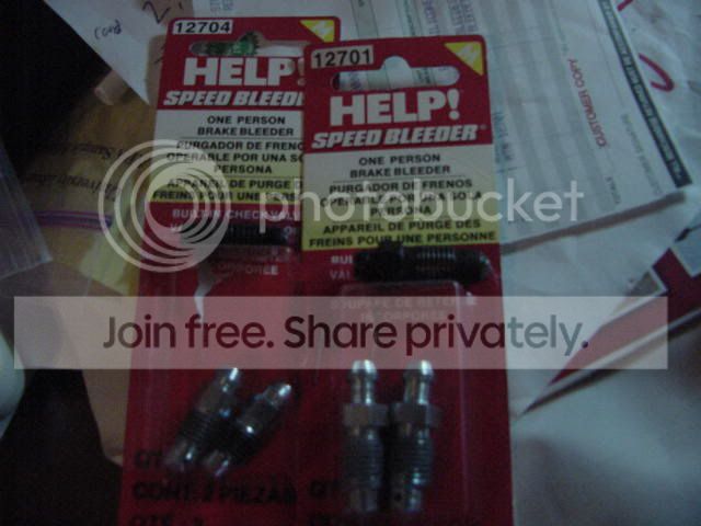

got me some speed bleeders *pic*
78Suburban
Jul 4, 2005
2,609
Georgia
I'm about to see how well these speed bleeders work. I emailed the company, and they said that the HELP brand were made by Speed Bleeder.
the big one is 3/8-24 thread and the little one is 5/16-24 thread. I got them to thread my old bleeder screws onto some nuts and they were that size, and they look good, so I assume they'll fit. The speed bleeders have a longer point on the bottom, but I dont' guess that'll hurt anything.
I'm about to run go try it out. The bleeders were 12 bucks a pair at O'rileys.
I have those on my rear discs, they work good. Just make sure you keep the caps on them (I don't see any caps in your pic), or mud/water will play havoc on them.
I'm thinking they worked OK, but I didn't have a clear rubber hose to slide over them..
Also, I'm afraid on my driver side brake line that I drilled out, the hole had a very mild angle on it, and it appears to be leaking from there now..
The brakes are kinda mushy, I need to rebleed and address the driver side fitting... but slowly but surely they do stop the truck :pimp:
