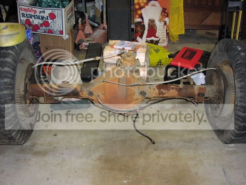

I just got back from Ramona,CA about one hour ago. I haven't cracked it open yet because I am about to watch the UFC 66.

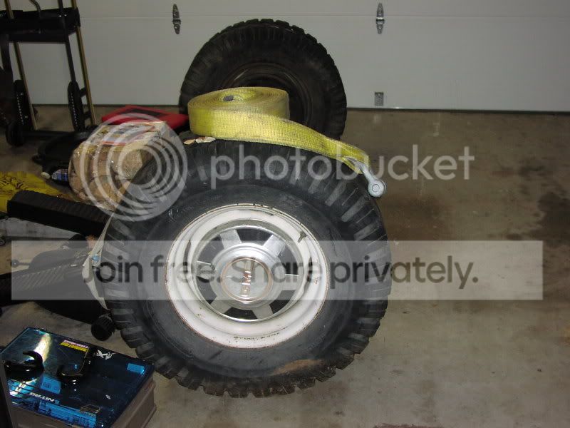

Only thing that worries me is, I just noticed the wheels on it are 16.5x6.5:( I hope my 15x8 rallys fit on here because i just got new tires a week ago.
Here are some pics. It came out of a 3/4 ton camper special 74-80 GMC truck.

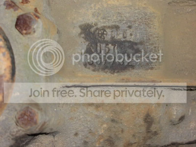

The numbers in the pics you see are 3977323 and on top of that it says 157.
What do you guys think?? I picked it up for $100.00. I will replace the brake lines/drums/shoes/wheel cylinders. This sat for 15 years and came off a low mile truck with 68k!!
Not bad, seems to be the growing rate.
I was extremly lucky to find mine, completly rebuilt w/ a detroit for 125 bucks:eek1::D

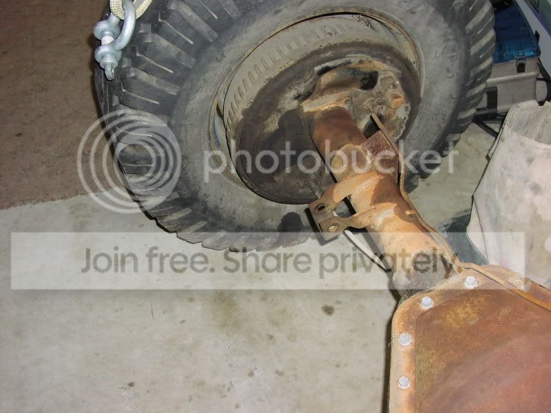

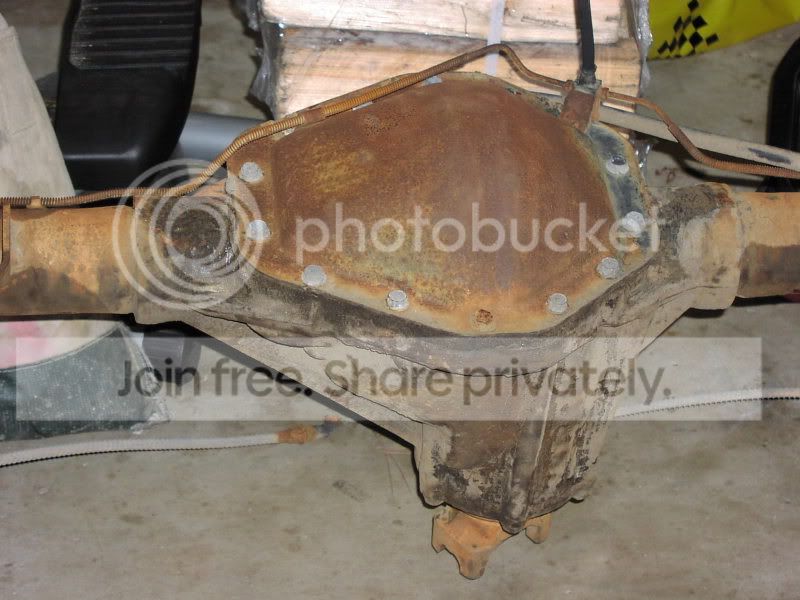

Thats about the going price as a good deal. It appears that it may have some seal issues on the driver side?
Not a bad deal. You won't have any problems with your wheels on there. I had 15x12's on my last one. It does look like the brakes were leaking on it. It would be cheaper and easier to just go ahead and do the disc swap instead of replacing the drum brakes, unless you want to keep the e-brake option on it.
ARent your current wheels 6 lug? size doesnt matte if you have the wrong lug pattern... 15" rims will clear a 3/4 ton 14 botl though

Its rare the drums need a full overhaul... often the adjusters are seized so the shoes/drums have very little wear. Hub seals, hardware kit, and wheel cylinders are all I've ever replaced on them. :dunno:

100 bones is a decent score!..most places get at least 150 bucks here,more if they know what ratio it is or if its a posi...your lucky,anything that's sat outside 15 years here,you wouldn't have to pull the cover,it would already be rotted away!--I'd definately pull the cover,check it over good,and flush it out with diesel fuel, and put new gear lube in..see if its posi too while your in there seeing which ratio it is!..new wheel seals look inevitable..:crazy:
Well, I cracked her open and discovered an open diff with 4.10s. I was hoping for 4.56s, but oh well. Better than my 10 bolt with 3.08s. The way I look at it, buying this rear for only 100 bucks, the 4.10 gears are a bonus. I will just buy 4.10s for the front 10 bolt and be done with it.
Now, can someone give me a list of what I will need to make this thing work in my K5?
The way this thing looks so far, it looks as it would bolt right in without changing a thing:dunno: Even the shock brackets look like they are on the same sides as my 10 bolt:confused: I do need to buy new drums as one of them has a big chip missing from it.
My "to buy" list so far is:
new drums
wheel cylinders
mabe brake shoes
brake lines:confused:
Will I need longer ubolts since I have 4" lift blocks on my 10 bolt right now??
Also, since I had my K5 lifted, I still noticed the saggy butt, because i just did 4" blocks for the rear. I thought I read in here somewhere that when you go to a 14bff/14bsf axle it gives you an extra 3/4" of lift, this true?
What about the Ebrake cables, I have the ones I got with the rear end. Kinda glad I kept them because i might need them, do I?
Sorry for all these questions, I just want to be fully prepared when doing this swap!! You guys are welcome to add anything I missed as well. Thank you.
