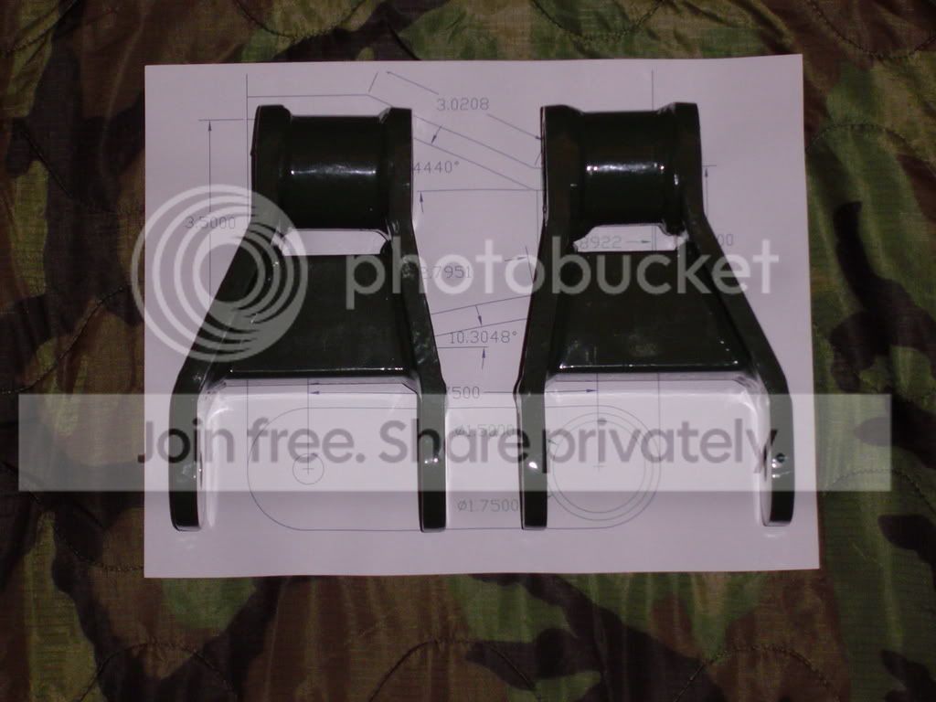

Got my homemade shackles back in preparation for my 1-ton D70 swap with ford 3" ide 57" springs. I'm stoked, so, not that anyone cares, I thought I'd show off a couple of photos.
They're a darker olive drab color, it doesn't show up well in the pics. After paying $80 to have them done, I'm gonna look into getting my own powdercoating setup.
You will make many "new" friends!
Your shackles look cool, they look "extreme duty"!
nice job on the shackles, i have a eastwood powdercoat kit and i highly recomend it. its payed for it self 100 times over. ive done dozens of parts for myself and made some cash doing parts for people.
Thanks for the compliments, fellas! I am quite proud of them if I do say so myself. Anyone know the best place to buy a powdercoat setup and approximately how much it costs?
nice fab work man... :waytogo: so is that the only option? noones producing one?
Not sure of where to buy the PC setup. I just had to chime in and tell you those are sweet. Did you do it all yourself or just the design phase?
I did all the fab myself, and most of the design. Before I got started on the fab I posted up some questions here and got some good advice from other members on how to bend the 3/8 flat bar. Then I sent them out for powdercoating, but the cutting, bending, drilling and welding was all me. I took pics of each and every step from layout to cutting to the final welding of the braces, I can post some of those if anyone is interested in fabbing up their own. The bushing sleeve took some lathe work, but it was not REALLY necessary. I used 1 7/8 x .375 wall DOM, and turned the ends down to 1 3/4" to fit the 1 3/4" holes I drilled into the shacke side plates. It was a pretty fun project. Again, thanks for all the props, guys.:D
