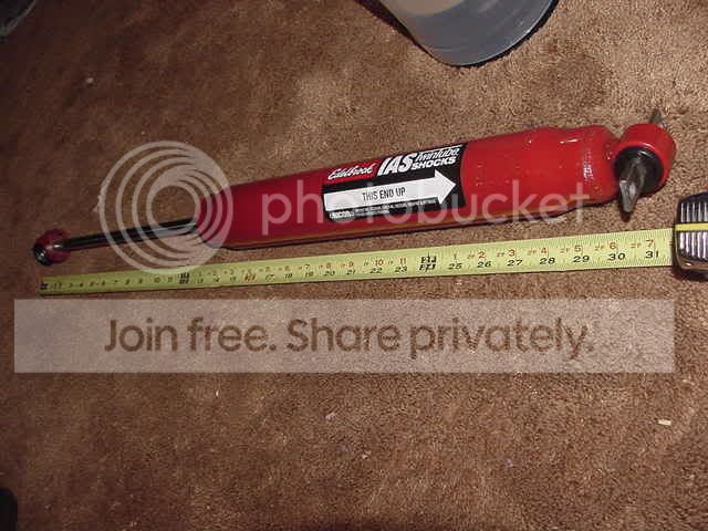

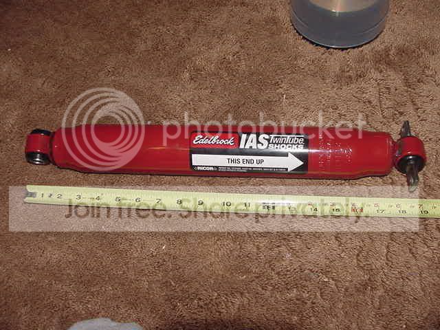

A fellow ck5er helped me discover these. For the money, since they're on sale, they're worth a try. As you can tell, the deminsions are basically the same as Gabriel G63438 shocks, but these may be better shocks. I've got ford towers, and I plan to run them at all 4 corners. Going to try to see what happens in stock rear mounting positions, if that causes problems, I'll inboard them.

what I learned from Paul (pvfrj) on the phone last night: To make them work, they need to be mounted with the correct side up (as seen with the arrow sticker on the shock.)
You obviously need to knock out that metal mounting tab, but it knocks right out with with a hammer.
The bolt right in the rear, that big stud on the chassis perfectly takes up all the room where the metal tab was knocked out of the bushing.
For the front, so that the width will be correct, when using Ford shock towers (which you'll need to do), you need to actually swap the bushings in the edelbrock shocks.. the top bushing goes in the bottom, and vise versa.
With just this small ammount of tweaking, its one heck of a shock, at one heck of a deal... I can't wait to see how they ride :bow:
