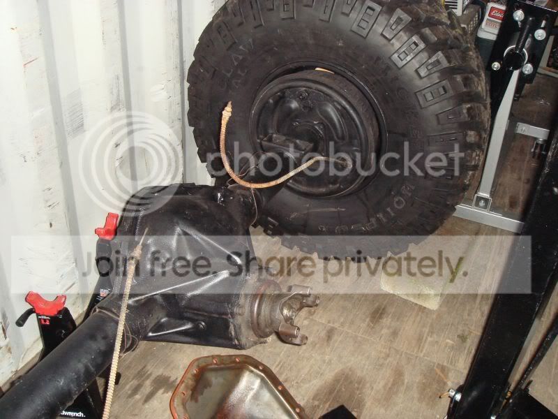

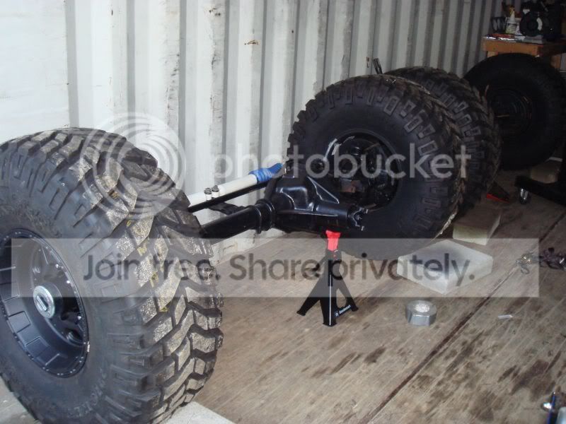

so i brought the 60 home yesterday and today i was checkin that and my 14bff out and noticed they have different wms to wms measurements the 14bff is like 3" shorter than the 60 is this normal? the 14bff still has drums. 60 is out of an 85 military supposidly. thanks eric

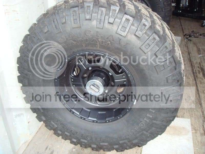

looking good man, 4.56's? Detroit? Are those teflon rims?
4.56 limited slip front. soon locker in rear (lookin for 1) no teflon. they are pro comp extreme alloys series 7089 powdercoated. $120 ea 37x13.5 mt baja claw radials. thanks! let the headache begin.....
I think that it's like that so it will have better turning manners- tighter turning radius specifically.
