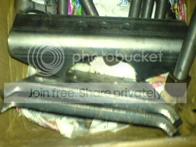

Looks like your upper ubolt plates need to be turned 90 degrees.
the bends in the plate should be front and back, not sure if it will hurt anything or not having them sideways.
If I rotate the plates, the u-bolt holes do not match up to the u-bolts.

I don't know what you mean by the bends in the plate. These plates are totally flat 1/2 inch plate.

ooo...ok
ok...the next to last pic looks like the plate bends up:crazy::blush: like these:
did you make the plates or buy them? these are ruff stuff that i got for my 14bff rear, i want to replace my front plates and ubolts also.
I got the plates from Speedo. Thanks Gus!
