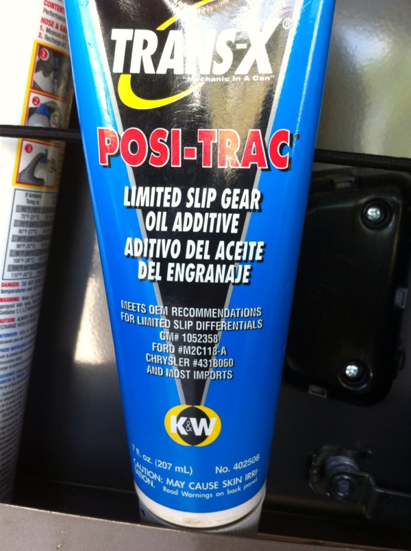

Okay, I'm adding the gear lube recommended for the rear but the the only thing they have at the parts store is this limited slip additive. Will this stuff work good in a Gov-lock limited slip rear?
You don't need it. A Gov Lok is purely mechanical, no clutches. Just gear oil and be done.
It states in the GM mechanics manual the additive is required for Gov Lock differentials!!
Trust me! I didn't add it it my first 10 bolt diff an it ate itself up because I didn't put it in! I was young an stupid back then!! I've since learned to put the additive in. I just don't feel like buying it from the local GM shop this time an wanted to know if this stuff works as good as the GM additive!!
Wrong...a gov lock works by a speed/slip sensing govenor engaging the clutch packs.
NO additives....just use the right (equivalent) fluid only.

So I guess I'll just add the 3 qts. of 80-90w Lucas oil in the rear an skip the additive then!!
