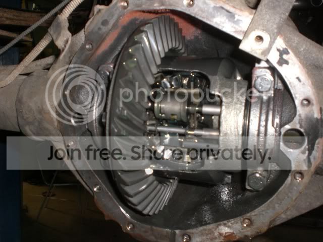

When I opened up the 12 bolt rear end on my 77 Blazer I found brand new gears in it with no ware marks. The Gov Lock is obvously warn. So any failure before I fot it couldnt of been a result of the gov lock. It does have me concerned a bit. This is a Gov Lock Correct? Is the same Gov Lock used in the 10 bolt as the 12 bolt?
gov loc yes.
same open carrier style up to 14semi float.
14ff goes to full carrier incased unit. pic posted of 14ff unit.

Just to clarify...
same type, yes
same size, no
If you were looking for a replacement gov loc, one from a ten bolt will not work in your 12 bolt.
