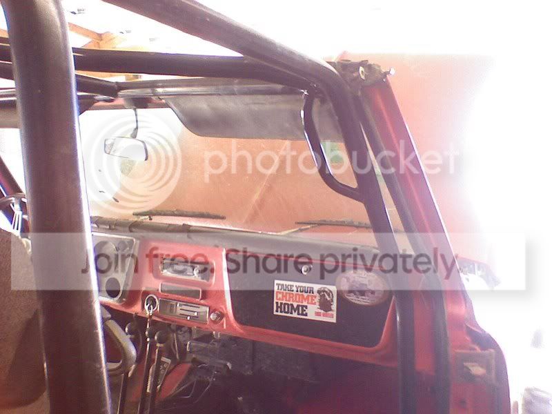

I made one out of some solid bar stock we had laying around, bents little legs on each end and welded a small plate with a few holes in them then self tap screwed it to the a pillar on the pass side. worked really well.
pics? Im interested. is it in your 71?

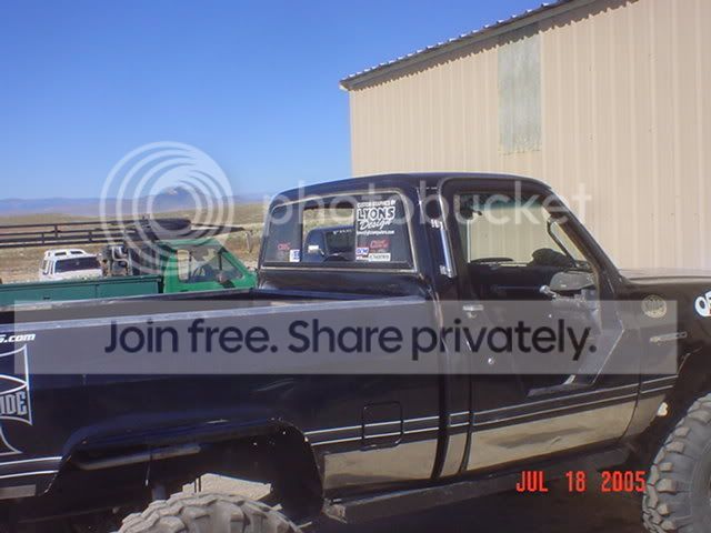

na, that was in the black truck. I can look at my home computer and see if I might have a pic that you can see them

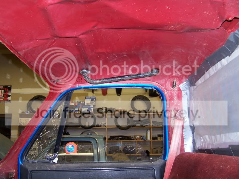

i also had a semi truck grab handle, the kind on the side to help get in on the dah of the black truck too
theres were holes in the cab above the door already for handles, at least in my burb there was.
I took a inside door puller handle thingy from my stepmoms new yorker back door and screwed it in. I dont think shes even noticed it missing

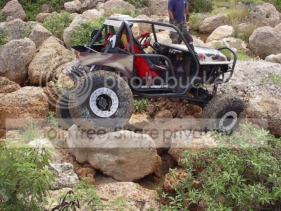

Thanks. Just to let you know that bar is for both the frt & rear passengers. You can ee it in this pic a little. Best one I could find:
