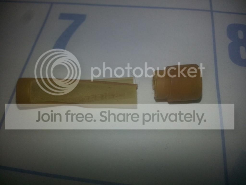

This is what ethanol fuels will do for you on small engines..
long story short... This is the fuel screen out of my Yamaha Grizzly 660...
After rebuilding and cleaning the carb twice,, then replacing the Carb,,,adjusting the valves,, replacing fuel lines...swearing/screaming/cursing the Gods of internal combustion...
I found this floating around in my fuel tank.....
According to the techs at Yamaha,,,due to the ethanol in today's fuel,,when you leave the tank partially full and the screen is not covered in fuel,,the plastic dries out due to the ethanol and begins to fall apart.
I jacked with this problem for a few months before I ever knew ( my own fault) that ATV's even had a screen in the tank (on the petcock) ...
26.00 later and a trip to Yamaha,,, a new petcock was installed,, the carb cleaned for the final time....and now it purrs like a kitten....
One of life's hard lessons learned...:rolleyes: :whistle:
