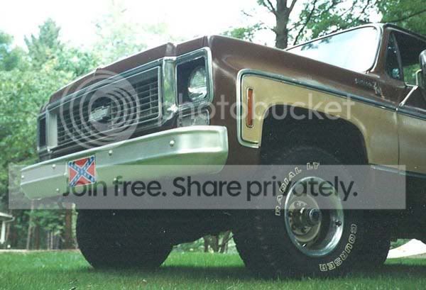

I once (gulp) cut up a '73 grille in order to get it fit on a '78 truck I had back in highschool. I couldn't locate the bracketry for the hood release (I probably just didn't look hard enough) and just cut the center to allow the grille to slide back into place. Yeah. It looked like crap. I have a pic of it I'll post when I get home...:doah: I eventually swapped out to a '75 grille since I had a hood release for it.
Here's the '73 Grille I butchered to fit my truck back in highschool. :doah: You can see the center section cut out and I didn't get it quite perfectly in there either...
On a side note, that's a rattle-can paint job...
