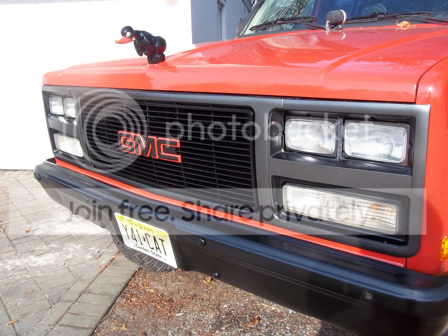

The duck:haha::haha::haha: gets me every time. Killer looking front end man:thumb:
thanks.... :D
the mallard makes me smile every day... best $150 toy I've ever bought... I'm very happy with how the front came out, color combo, emblem, etc...
down the road at priority #73 is to make a bumper for it... but that is WAY down my list of schit..
