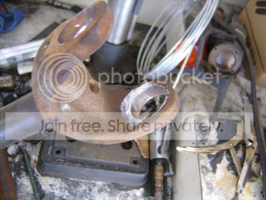

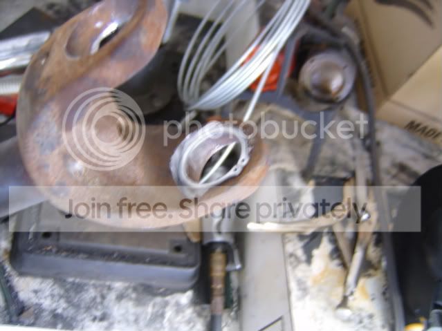

I'm going to do this on some 35 spline dana 60 stubs and want to make sure it's as easy as using an angle grinder with a square edge disc. Is there anything to watch out for other than grinding too much?
I have done it with a grinder before.Thats pretty much it.Only grind as much as you need to :D
I did mine with a die grinder. I would have thought an angle grinder would be too big to get in there.

Yep, I haven't installed the axles in the housing yet and discovered the place I bought them from only modified the inner shafts and not the outers.
Also, an angle grinder with a larger diameter disc does seem to fit. It looks like about a 6" blade will reach in there using my grinder.

Or I wrote it wrong. What I meant is a couldn't get my angle grinder in beetween the ears of the axles.
I guesss with a 6 inch disk it will.

I discovered that after I left to buy one. Turns out there's a 7" cutoff wheel type or a 5" grinder blade. The 5" seemed to have worked ok, but just barely.

Yes, you would have the shaft removed from the axle and the u-joint removed from the yoke........but not because of the issue you mentioned (the hub is sealed from this part of the shaft so no way you could get metal shavings in the hub bearings), but rather it would be a huge PITA, if not impossible, to try to grind an axle shaft yoke for full circle clips with it still in the axle and u-joint installed. And besides, you have the take the u-joint out of the yokes to get a full circle snap ring in place anyway so what's the point of leaving the shaft in place????
I suspect he was just asking to clarify where the grinding was being done. If I was grinding the end of the stub inside the area where the locking hubs are installed, then that wouldn't be so good. The portion of the axle I'm describing grinding is at the U-joint so there are no bearings or any other stuff installed.

Oh, so in the post you quoted in your reply that included the two big pictures showing the shaft yokes and where they had to grind to fit full-circle clips on the u-joints, and the text in that quote you highlighted red.....sorry if I didn't realize you were talking about something completely different. :rolleyes:
If there was anything at all that even looked remotely close to the picture inside the bearing hub / locking hub I would accept the explanation.
So I ask again, have you ever looked closely at a front axle?
