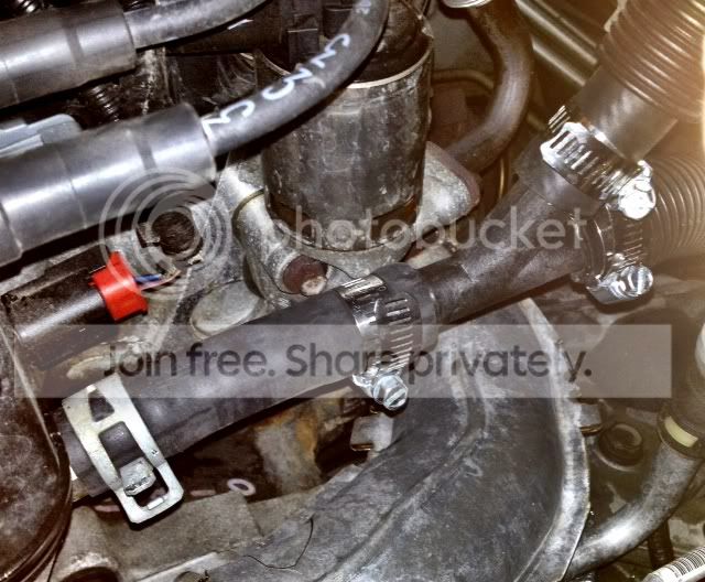

2009 Dodge Grand Caravan Grocery Grocer getting starting overheating yesterday.
4.0/6pd/80,000 mile
Its typically this design flaw (Y-pipe, pictured) that fails. Say three (3) time since we've owned this mechanical marvel. However not in this case. After the van gets up to operating temperature it starts to dump fluid into the overflow tank and the temp gauge eventually pegs. Gonna start with the simple stuff, replace the thermostat, and radiator cap.
What else should I be considering, besides getting something else.
