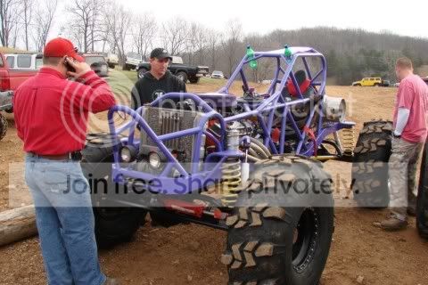

neither one of those trucks cut the smaller lugs off
oh i know i was just saying i like when people do lug them... sorry should have been more clear
Well, though this thread should get back on topic. :D

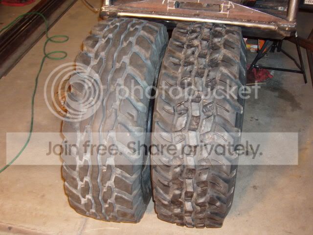

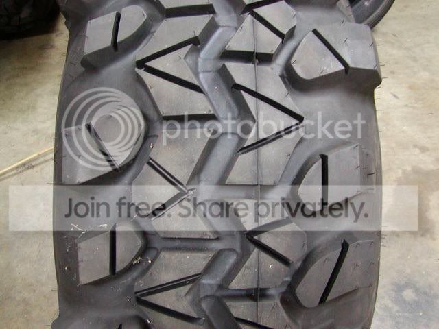

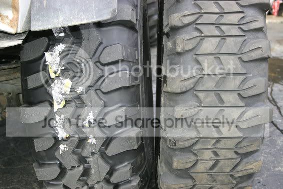

Not the "coolest" groove job, but I like it alot better than before. Just a simple center lug cut in half. Seems to do much better about chunking the lug compared to my buddies "cooler" groove job.
Hey, what can I say, them suckers were expensive, I need em to last.

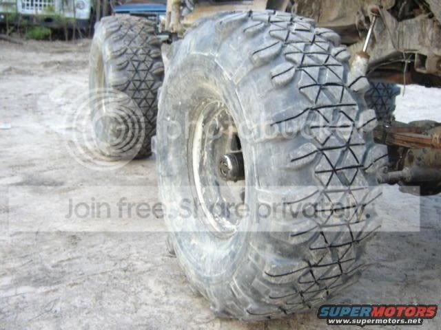

Here's the best cut of Humvee tires i've seen.

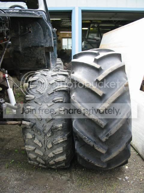

swampers turned into AG tires:
the rest:

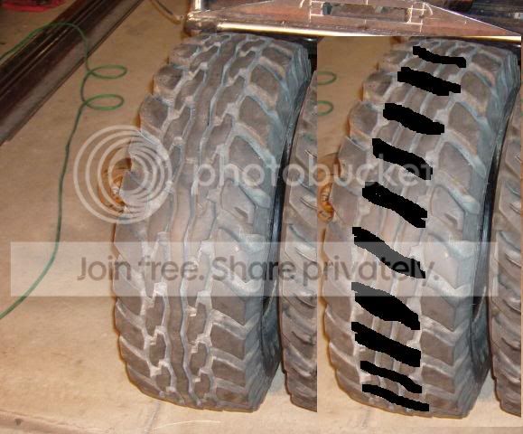

if it were me, i'd either do the AG tires, cut the center blocks, or if the tires was really wore down do this:
or this, cut out the black part so it's kind of straight lugs right across, like this.
put some wide masking tape on the outer lugs and follow it across to the matching lug. use wide enough tape so it covers the whole lug. then cut away what's not covered by the tape.
you get the idea.

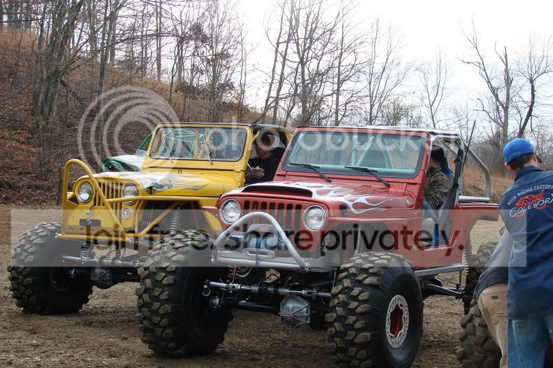

Now that I think aboot it the orange truck is the one I was thinking of that was cut like the boggers I have seen.
Dik

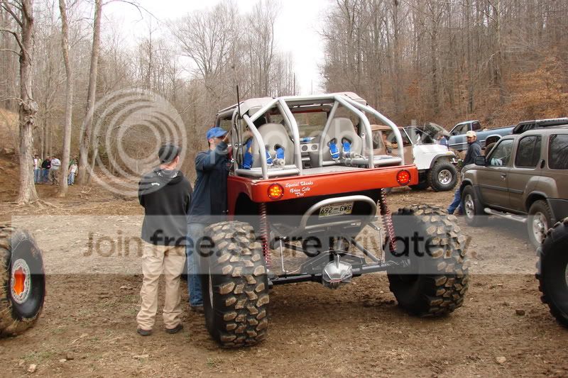

Yea that orange s10 is the one that was in Top Truck Challenge last year, 46" Baja Claws
