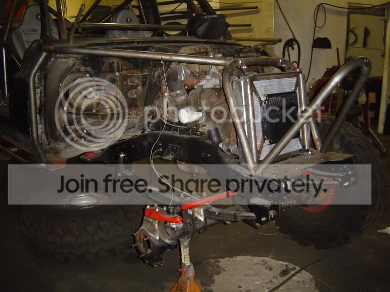

Here's what STOMPER did to strengthen his Furd d60 knuckles. 1/4" plate added to the front, back, and outside toward the tire.
Thets kinda what I had in mind, I was thinking 3/8 to 1/2 strap just down the front though. Do you know how thats holding up?
