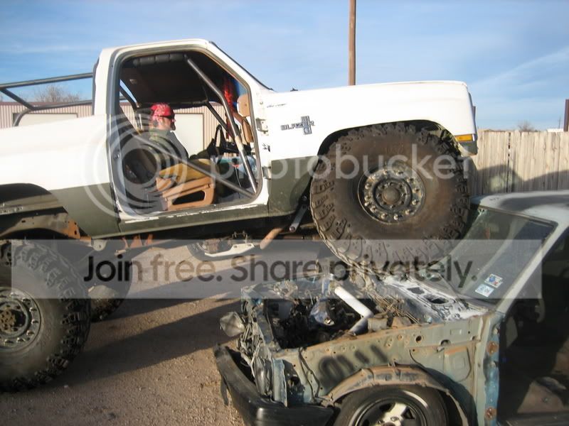

I have a pic of my recentered 8 bolts if that's what you're looking for.
I'll probably be adding some more beads to the rockrings, but heres a pic for now.
