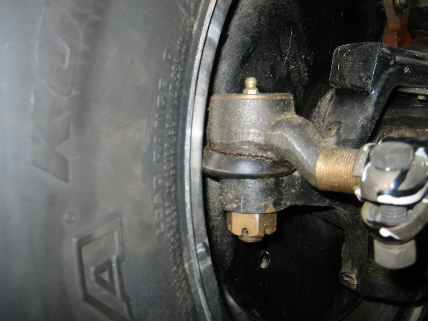

Mine rubbed my tie-rod dust boot, by jusy a real little bit. Others have reported they don't.
Mine are on a D44. I used a 1/4" spacer.

Miner are real close to the tie rod, but nothing to worry about, mounted on a 10 bolt front.
