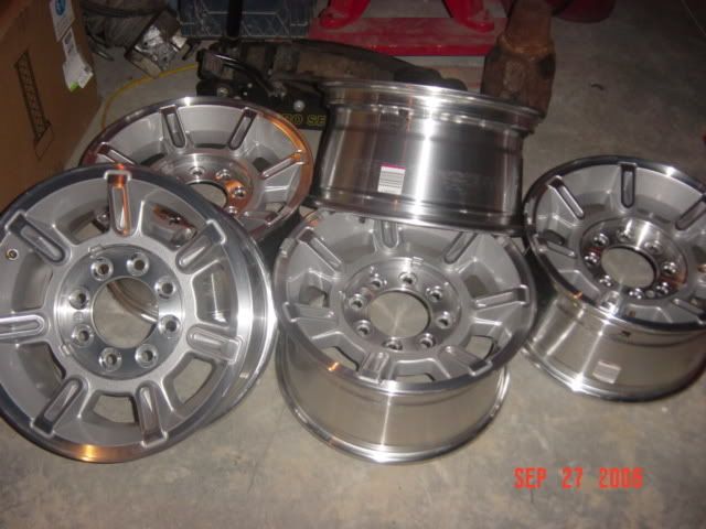

You have to bore out the H2 center hole to 4.775" to fit the hubs on the Dodge.........now way around it you have to hog the center holes out.

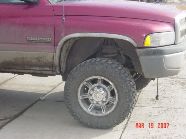

like my old girl...........and you get 3rd gen center caps, trim back the skirt almost 1" and trim about 1/16th off each tin retainer. and voila you have dodge centers. looks factory :laugh:
o cool, thanks. my friend actually found ur truck on google one day and thats what made him want some h2 rims.
where did you have to remove material...? actually, for which axle...? both of my brothers' dodges don't have any mods to the wheels... or is it because they're the older, pre '94 style...?
and that looks way cool with the stock dodge center caps...!

the material you remove in from the center hole........make the center hole bigger. I used my die grinder to open up my 1st set with no ill effect. you can hole saw it with a 4.75" in a big drill press. or the fancy shmancy do it with a milling machine.
look close, see the material in the center hole. its radiused. you basically remove the radius lip. stud centric is more than good enough for these.
