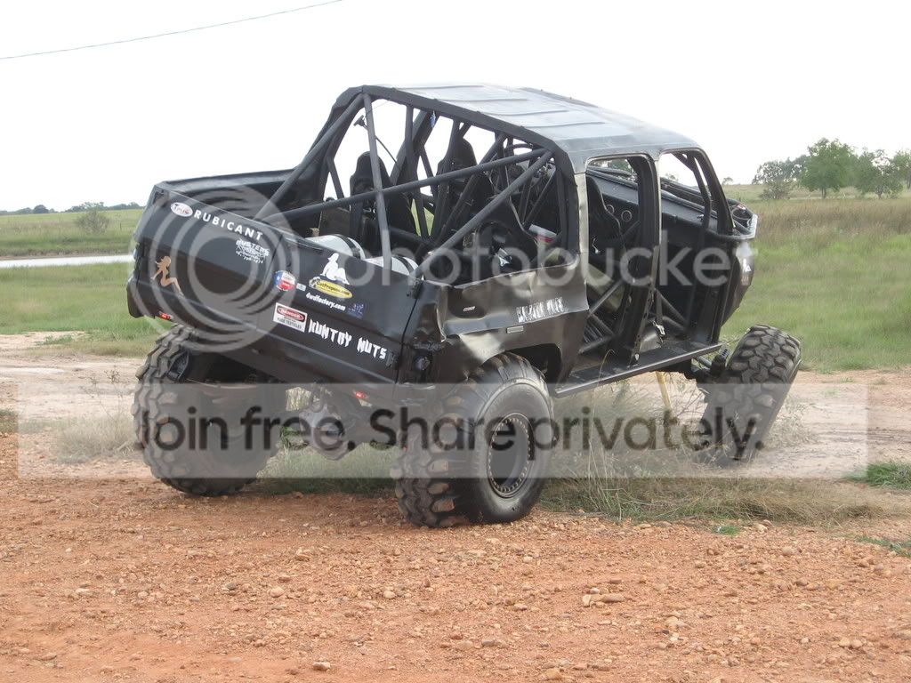

Heres a burb with the top cut off that I found on ebay

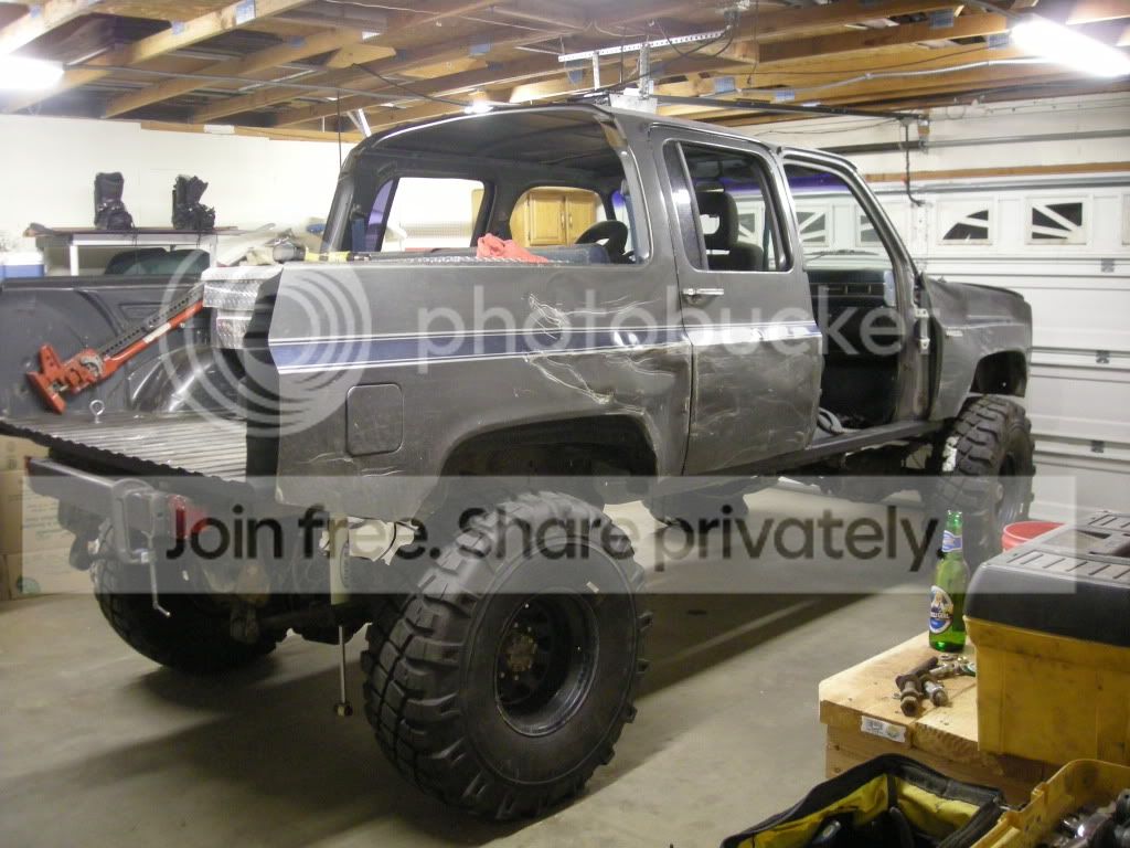

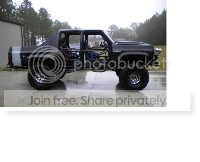

I did a little paintchopping to make into what I want to do. This really makes me want to do it now.
I think I like the angled piece in the back. I think I'll make one similar to a stock avalanche one out of dimpled steel.
that'd look awesome and original you should go for it and post pics! that photochop looks cool
