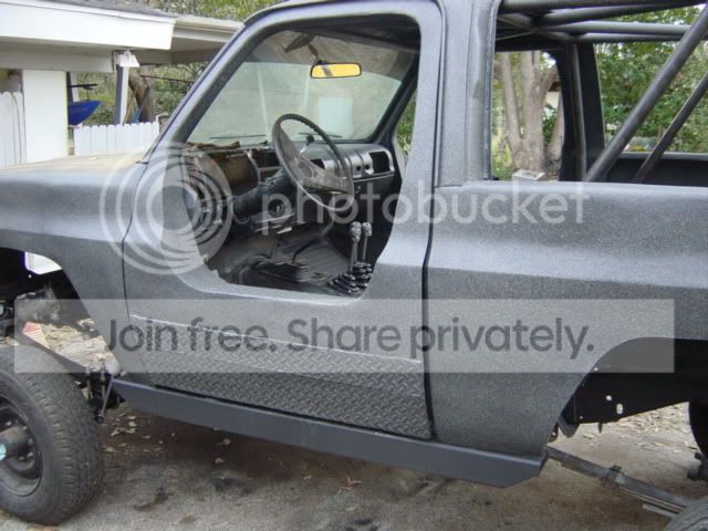

I have several hours in each door .I boxed out the bottom of the opening with 3/4 inch square tubing and welder diamond plate on it.I ran heavy guage sheet metal up both sides.I filled the window track in with a piece flat bar and bondo.I also welded dp on the out side bottom for protection.I think I have some more door pics on my webshots.I need to update it with some more recent pics
Well, mine aren't remotely as nice as 82dieselburb's ... wow... somebody can WELD!
but here they is. I just put a piece of diamond tread across the gap horizontally, and then sheet metal along the vertical and top edges, if that makes sense. They have a little give, but not much. I chose to keep them pretty high, which in retrospect looks funny ... but still feels like you're doorless at 70MPH! :blush:

No sturctural support (as seen in the photo), and about 2 hrs in both doors... and that included time to stop and drink several frosty cold beverages along the way
Those doors do look like they have some serious time in them 82dieselburb, and they look pretty awesome. And the others also look good too. Thanks for the pics, and if any one has any more please post them up. Thanks.
Cory
my 2 cent would to be to mimic the missouri offroad ones those look nice and keep ur locks if that matters. base some off those or 82dieselburbs. both are quality setups
