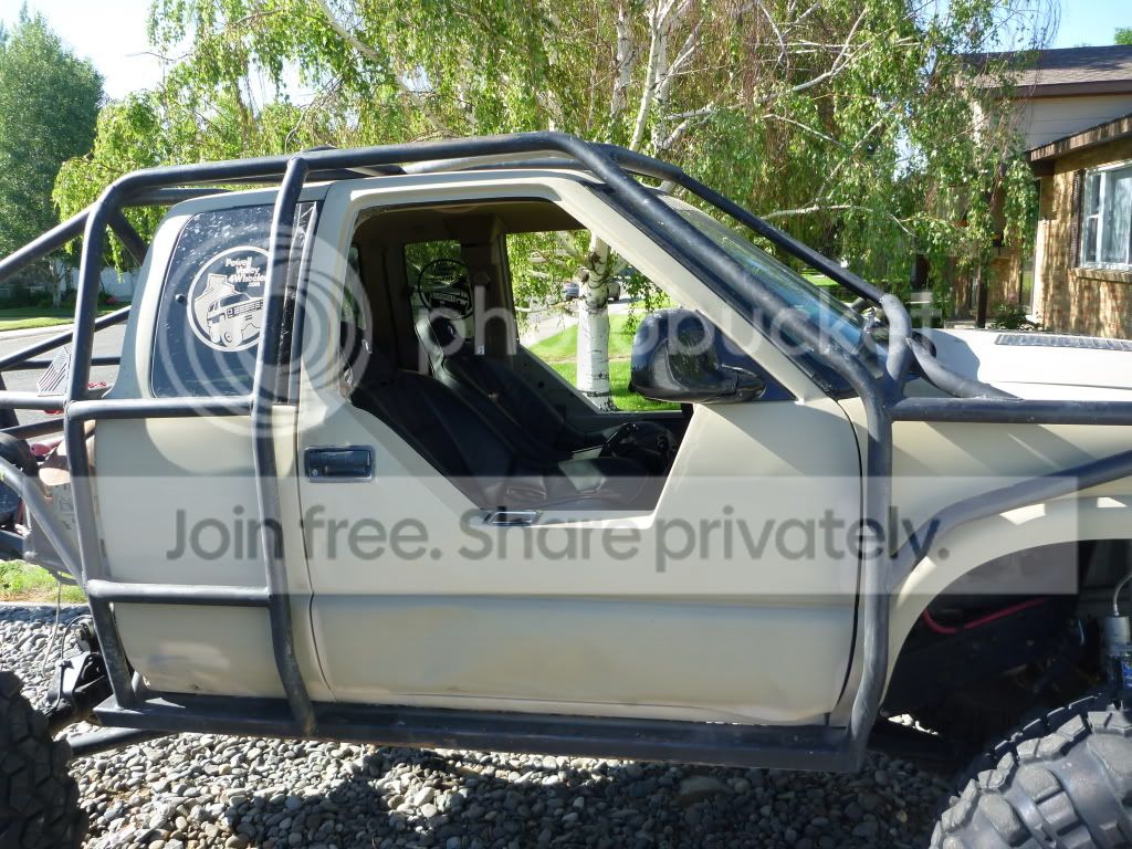

See there was some talk recently about half doors. Just finished a set on my Sonoma. I used the same basic design as I did on my old fullsize too. Installed a inner latch so I can have a soft insert made to be able to snap in.

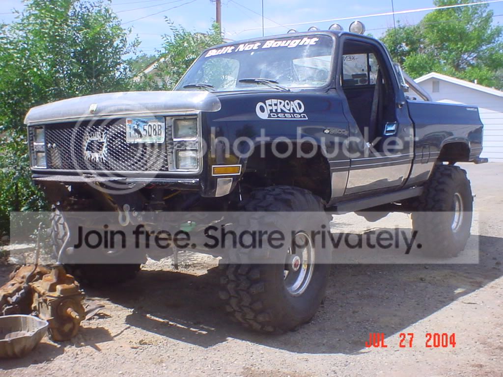

Old black truck ones:
I like 'em. Any pics of the inside and how you hooked up the inner latch?
I don't have any good pics of linkage but just took the factory rod then cut it length and attached to the latch.
I like the latches,r those the freight liner style?
THe ones on the black truck were some kenworth latches we had laying around. The ones I used on the Sonoma are from napa and made for a toolbox type latch and has a striker to be the actual latch. They have a 1/4" threaded hole in the striker so I threaded in a eye bolt then hook the rod into that.
i love the shape but you forgot the built in insulated cup holder
I thought about cup holders but thinking about it putting the drink out in the open sun isn't probably as good. I have a pair of bicycle water bottle holders mounted between the seats for drink holders.
