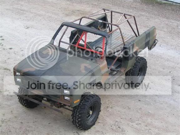

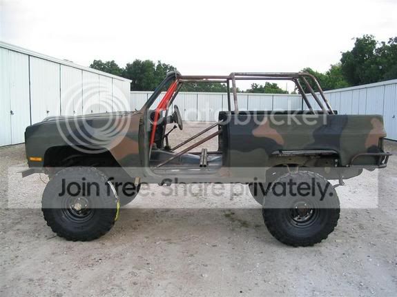

Here is a comparison from the S&W cage vers a custom built cage. You make the choice.
hey cegusman did you use the s and w roll cage kit an just add more metal and move the front pillar tubes up closer to the dash?to it to get that final cage?
I beleive he ended up having the entire cage built by a shop
