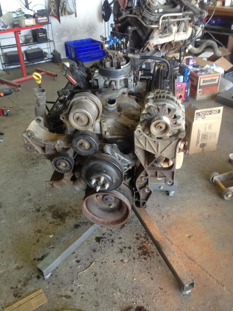

You can see in this picture that it doesn't have a rubber connector at the valve core, it slides into the grommet in the valve cover. This was the "least" broken one I could find out of four different engines I had.

You win with that photo. I replaced the soft line part on mine with vac hose.
